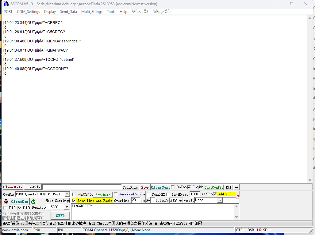

Please help check
AT+CEREG?
AT+C5GREG?
AT+QENG="servingcell"
AT+QMAPWAC?
A+TQCFG="usbnet"
AT+CGDCONT?

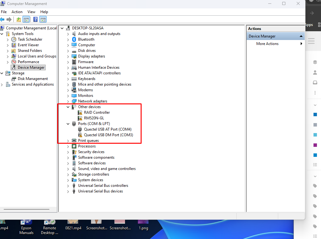

And please also show the device manager.
Just from the video it seems that it didn’t set up data call. Maybe it is not reigsterred or someting else like you didn’t see the APN.

and AT command not workings
AT port is not working. You need to solve it first.
As I guess you might have modified the usbnet sometime. Or it is just a hardware problem.
How do I fix this port? AT PORT
Do you have any other Windows PC? Is it the same situation.
yes this problem solved . i get
