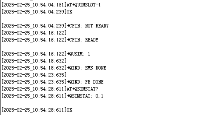

Please share your test AT commands and firmware version.
After change the SIM slot, SIM card have initialization.
