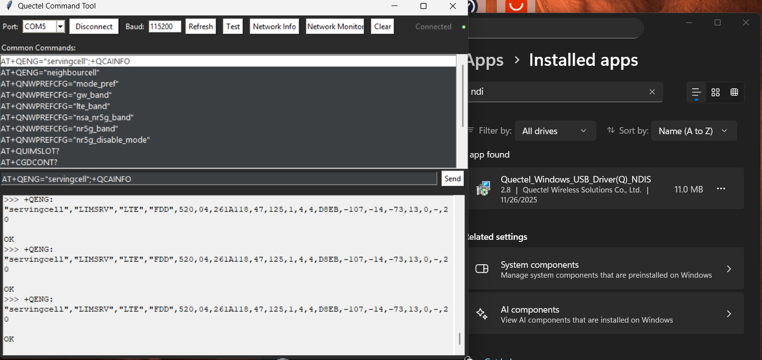

Still stuck in LIMSRV state

Do you have USB on your device? Is it possible to capture log?
Sorry, I don’t know what usb can you tell me like uart??
I think it is possible but I don’t know how to do it
Where download this tool?
Dear @Ham
Which OS do you use? Linux or WIndows?
Dear @Andy.alex
What do you mean? The tool to capture log?
Which OS do you use? Linux or Windows?
Windows 11 driver quectel ndis 2.8

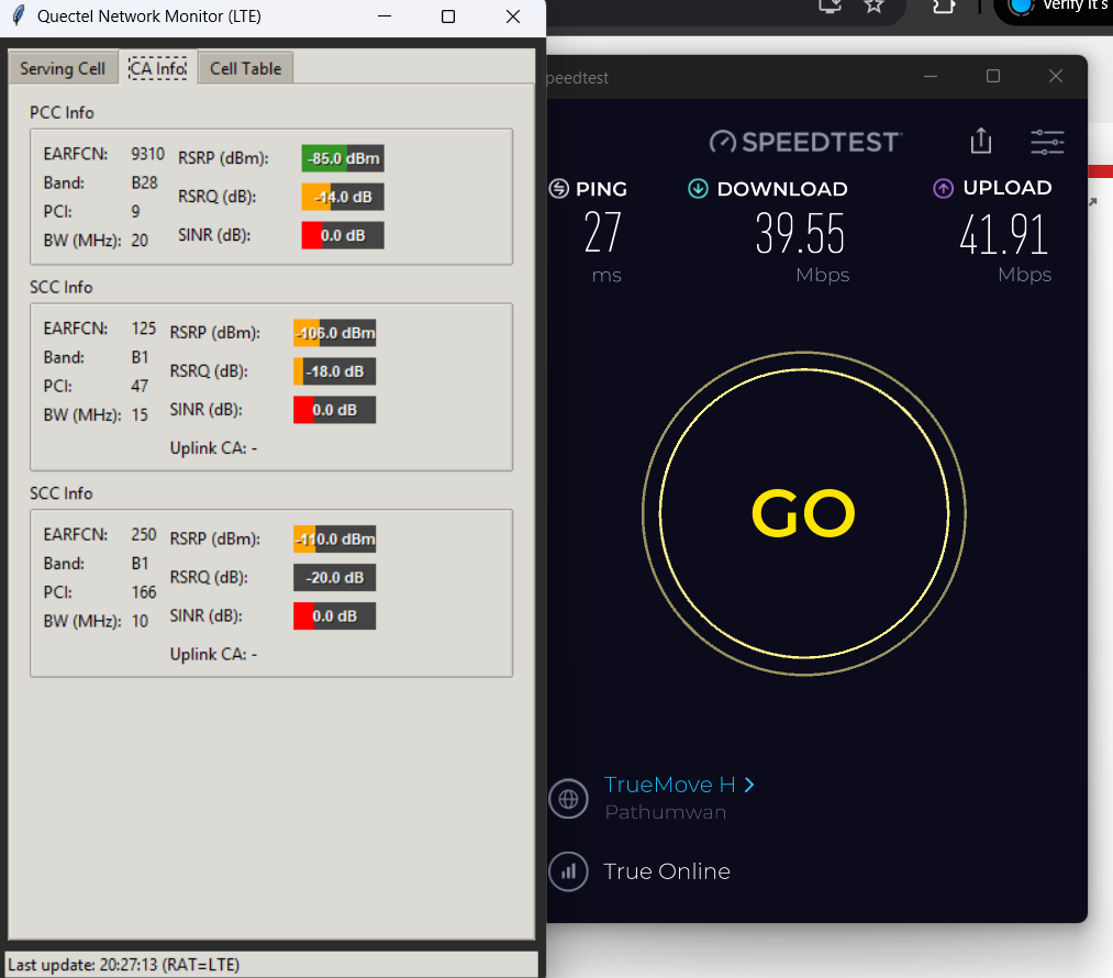

I just buy new usb to m.2 key b from waveshare
it works but 1:3:40 and 5g nsa doesn’t
i try lock 1:3:40 doesn’t work only if b28 is Pcell
Dear @Ham
Do you check with operator which combinations are supported?
Form your description, some NSA combinations worked fine, right?
For 4g in my area is 28+1+1 1+1 28only
