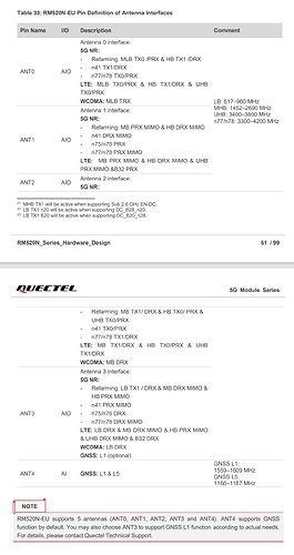

My question is how to connect the antenna in/outputs there are 5: 0: ?, 1: ?, 2: ?, 3: ?, 4: ?.
Best way to connect with a 5G dongle that has four, (Quad,4) SMA antennas connected, with 4 IPEX cables.
Do I need a 5th antenna for GNSS? -Like e.g. a Molex 1558-1610MHZ GNSS FLEX ANTENNA?
Or make the GNSS disable pin on the USB TO M.2 B KEY active?

I need especially how to connect antenas before powering up.
Dear @Jdn333
Please check the screenshot as below:
Thank you for your support.
