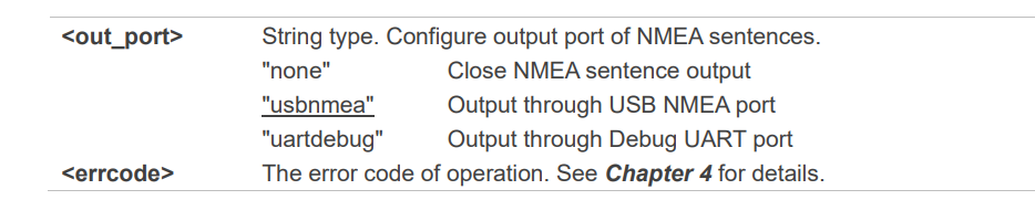

AT+QGPSCFG=“outport”
+QGPSCFG: “outport”,usbnmea

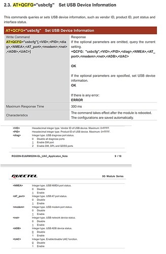

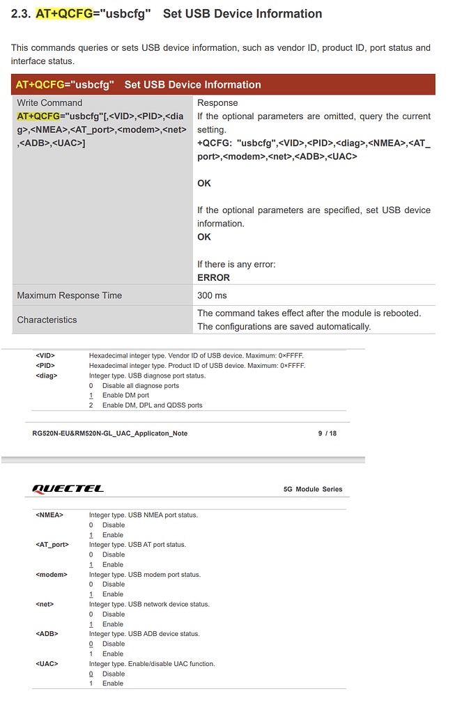

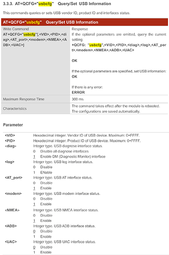

NMEA port is disabled, please enable it in usbcfg.
Image source:https://www.quectel.com/download/quectel_rgx00urm500u_series_at_commands_manual_v1-0/
:warning:WARNING​:warning:: This AT command is very dangerous, and incorrect input may have serious consequences. Please double check before entering the command!!

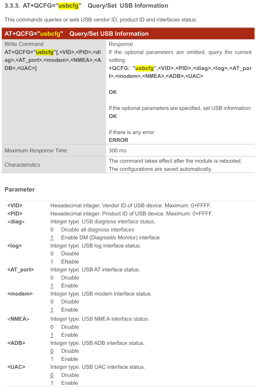

First, thank you @qows for responding and providing me another avenue to investigate.
The configuration from the AT Command reference (posted by @qows) is not aligned with what Quectel has provided me previously for the RM520N-GL. The below image is what I received from Quectel a week ago. The difference from the image posted by @qows is an additional “LOG” port. If the AT+QCFG=“usbcfg” from @qows is applicable to the RM520N-GL, this would obviously throw off the alignment of ports I have been enabling / disabling.
I will give this a try, but I’d also really like to get feedback from Quectel on which implementation for AT+QCFG=“usbcfg” is correct for the RM520N-GL with Firmware: RM520NGLAAR01A08M4G_01.205.01.205. I have to assume the one sent to me by Quectel from the RG520N-EU&RM520N-GL_UAC_Application_Note must be accurate and applicable to the RM520N-GL unless this has been updated in the latest firmware and the documentation simply hasn’t caught up yet.
See Below:
I very much appreciate the pointer
Obviously, as it is taken from the document related to a completely different modem - note “U” in the name. So there is no need to try and thank
So why didn’t Quectel add this command to the AT command manual?
RM500Q,RM520N,RM551E…It’s not even in the docs.A request from Qualcomm?
Can you share the document you mentioned? Thank you!
Upon closer inspection, I can see the suggested description for AT+QCFG=“usbcfg” from @qows can’t be applicable to the RM520N-GL. This does not include the NET (or Network port). Sometimes new configurations are added in updated firmware, and the documentation can take a while to catch up, so it’s sometimes good to review other devices’ AT command references, but in this case, it simply can’t be applicable.

Dear @svandive
RM500U is based on Unisoc platform. It is different with Qualcomm.
