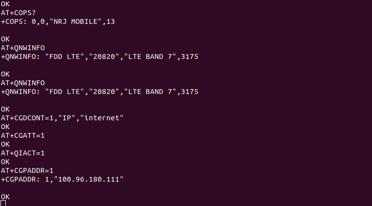

I tested the RM520 with a commercial NRG Mobile SIM.
The module successfully:
  • registered to the LTE network
  • attached to the operator
  • activated PDP context
  • obtained an IP address
This confirms that the RM520 hardware and firmware are working correctly.
