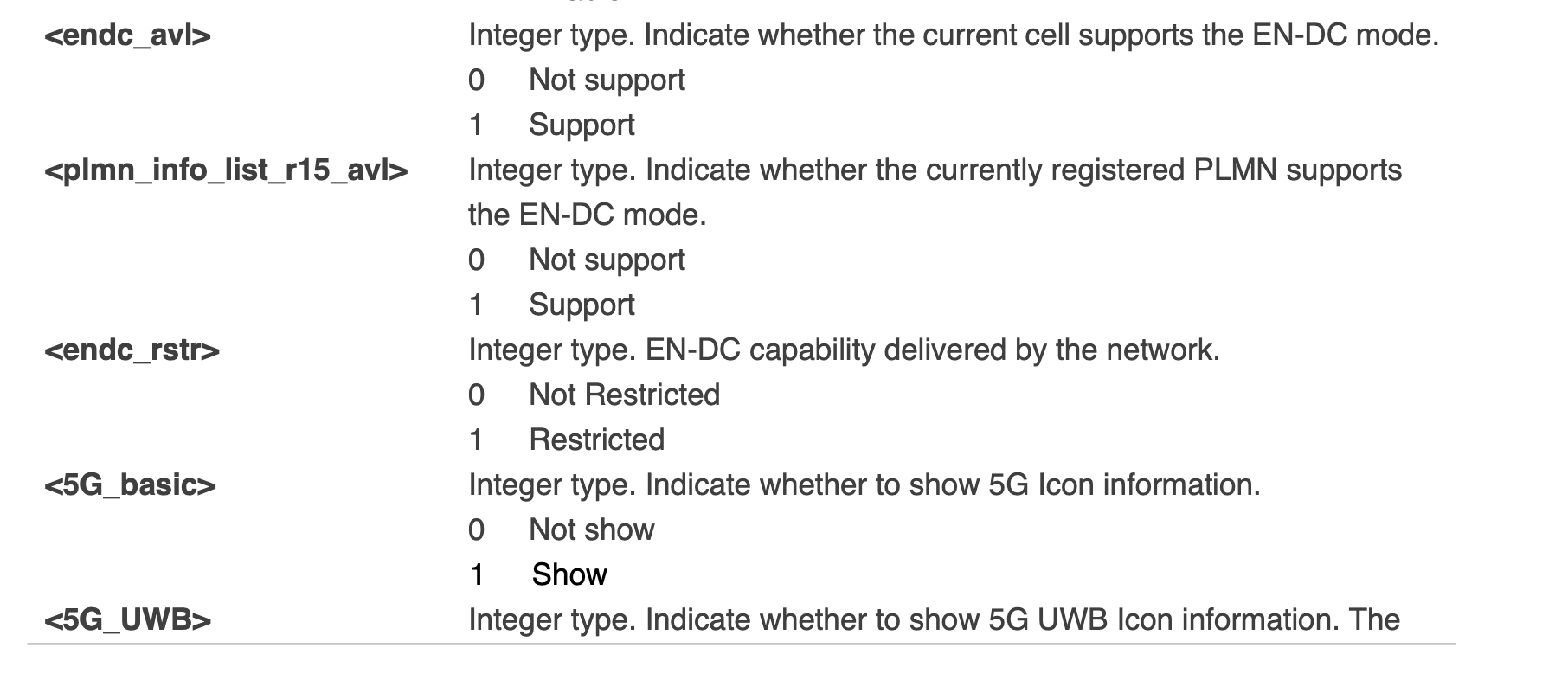

AT+QENDC
+QENDC: 1,1,0,1,0
based on 5G_Network_Application docs, it is not restricted. do you have any ideas why?

The fields shown in the documents are general information at the RRC/PLMN level published to the UE.
Does the current cell support EN-DC?
1 = Supports
This information only indicates that the base station is technically capable of EN-DC.
This does not mean that the relevant UE can connect to EN-DC.
Does the registered PLMN support EN-DC?
1 = Supports
This indicates that Telkomsel’s 5G NSA infrastructure is available.
However, it does not mean that the UE is authorized on this PLMN.
The debug outputs shared later reveal the problem more clearly.
