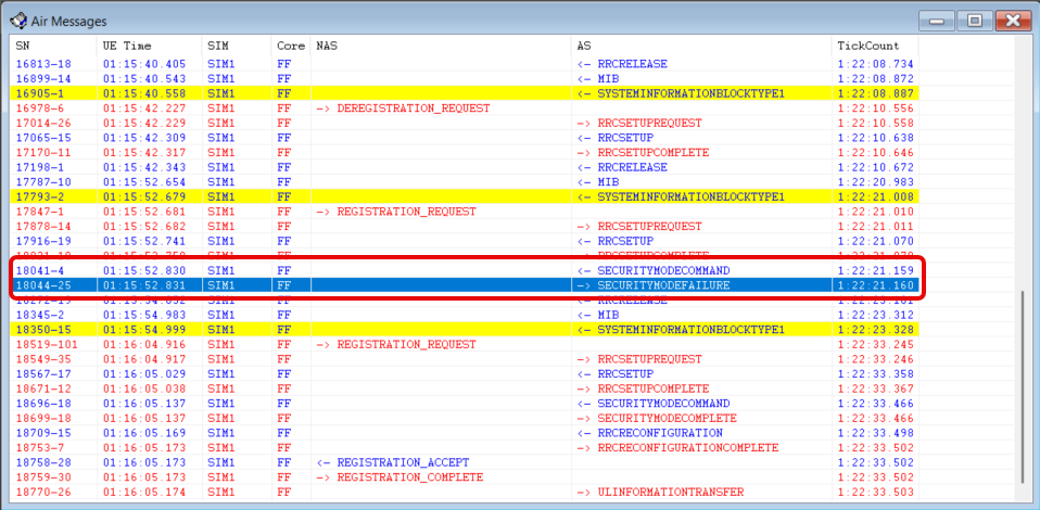

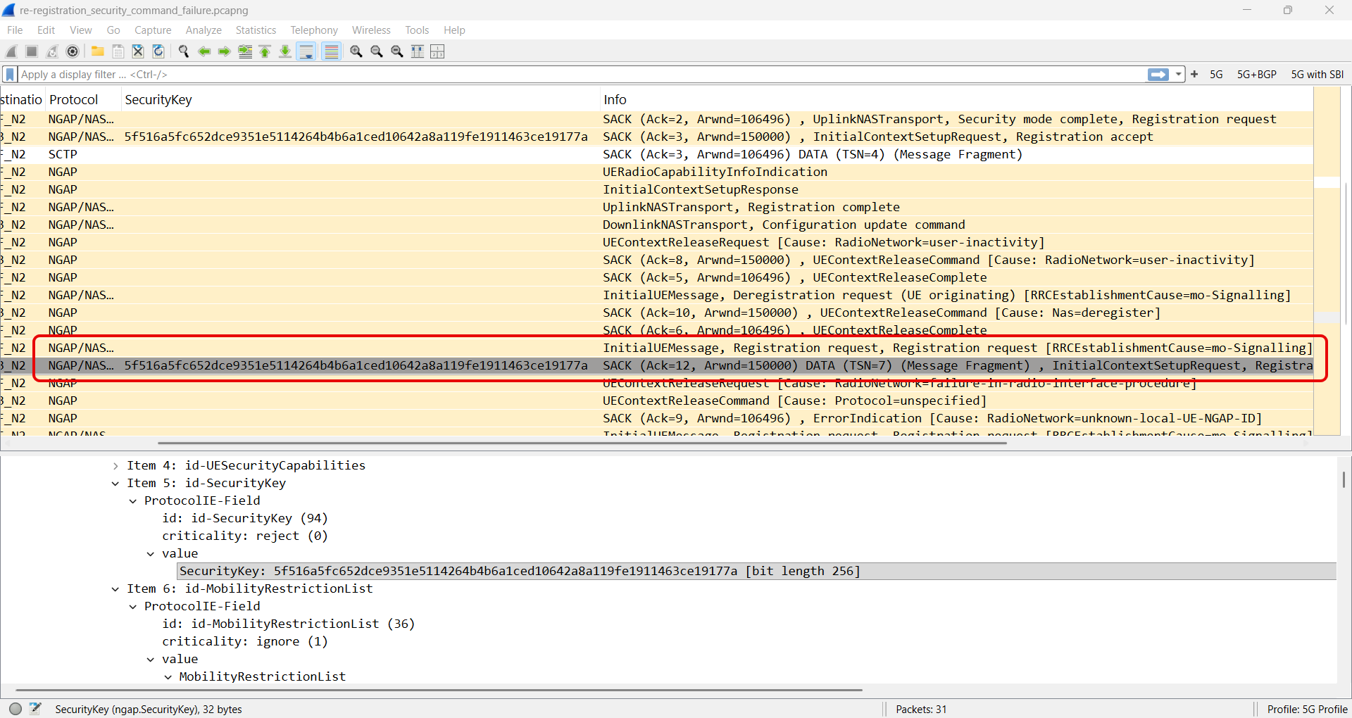

Following test has been performed with a RM500U modem:
  1. Make a 5G Registration
  2. Make a 5G De-Registration
  3. Make a 5G Re-Registration; the re-registration is requested using the last 5G-GUTI and accepted by AMF with the previously used SecurityKey. Anyway, the Security Mode Command is failing between UE and gNB.
Here the LOGEL logs and Wireshark trace.
Not able to understand if the issue is at UE or gNB side; not so expert in checking the LOGEL logs.
Can someone help me, please?
