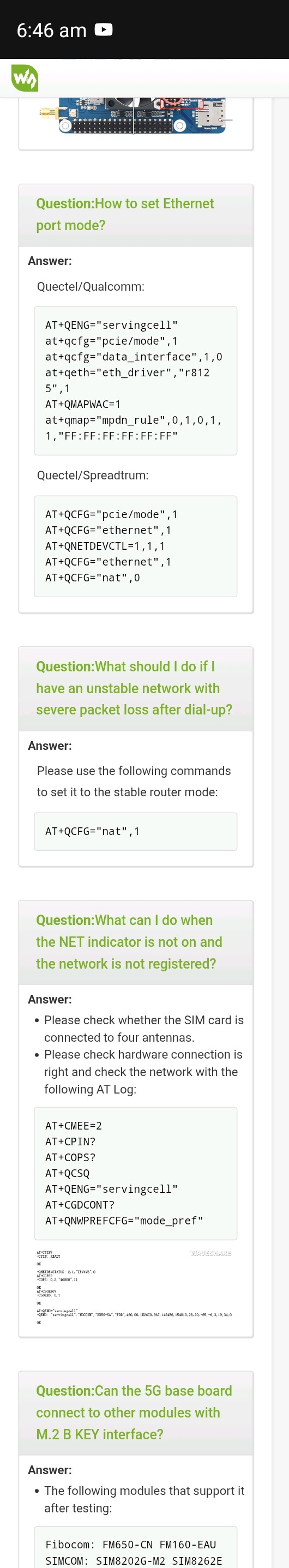

When flash to new firmware type command to AT+QNETDEVCTL=1,1,1 work fine but when restart or on off device then this process return follow type command to AT+QNETDEVCTL=1,1,1 then work if any solution to give auto reconnect without using at command

solved my problem thanks to waveshare documents here the screenshot to enable ethernet with poe
