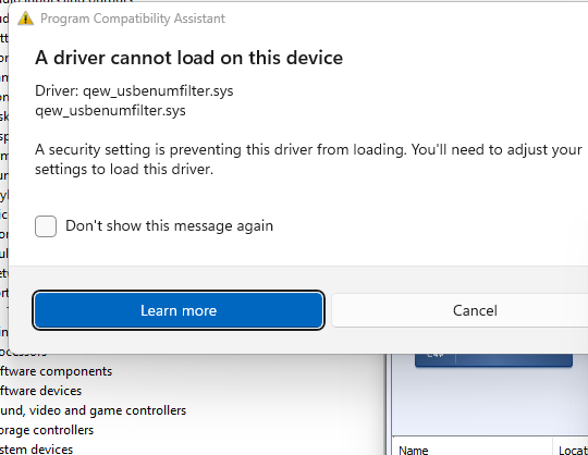

Hi herbert, I’m trying to install the driver Quectel_Windows_USB_Driver(U) and I am encountering the following issue, are you sure it is signed?

Perhaps it was the security system on your PC that intercepted or blocked the installation of the driver.
