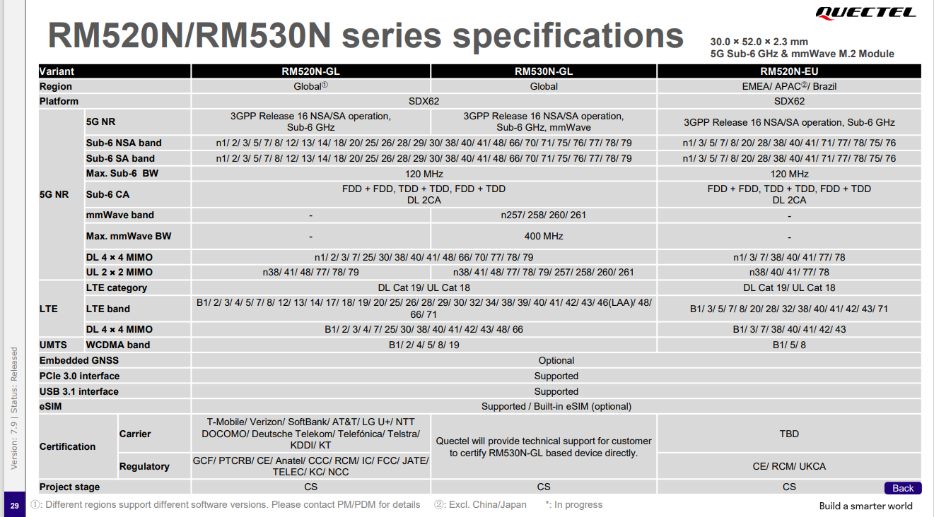

Dear @jpknuuti
RM500U and RM500Q don’t be recommended, they are EOL project.
For RM520N-GL, which combinations of CA do you want to know? I can share part of them.
If they are EOL, which similar products would you recommend, that support n28+B20+?+? CA? Also what about 4G 4X4 MiMO support, like RM500U-EB had?
About RM520N-GL, for us n28+B20 are the most important bands from CA point of view. We would be interested to know all CA combinations with these two bands.
Regards, Janne
