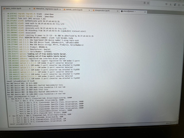

I see that the usb_wwan is loaded with the option kernel modules, but the quectel device is still not available. I can talk via ttyUSB2 but no /dev/cdc-wdmX

You can just use the qmi_wwan driver that comes with Linux. There’s no need to use qmi_wwan_q. Could you use the lsusb and lsusb -t commands to check if the USB device is recognized?
the usb is loaded (I see the producer and product IDs) but with lsusb -t, I do not see the wwan (or qmi_wwan). I believe it is because it is not loaded by default on arm64 platforms such as Jetson Nano or Orin. Would you know how to do that safely ? (without replacing or compiling the full kernel, just adding the missing modules )?
