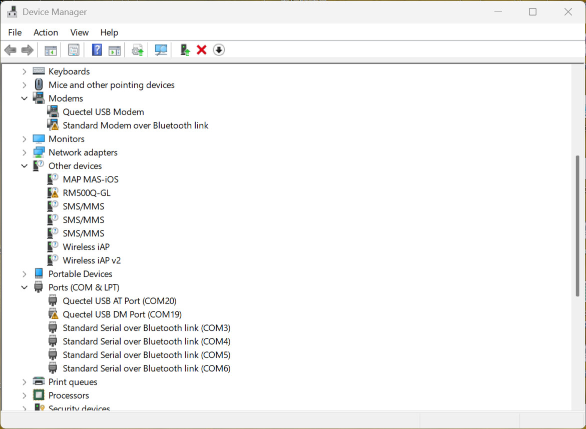

The driver is Quectel_Windows_USB_Driver(Q)_NDIS_V2.4.6 now. The driver worked yesterday, I sent several AT commands to register the 5G. The commands I tried: AT+QCFG=“usbnet”,3, APN setup and PDP context activation. However, I failed to register the internet. Then I executed AT+CFUN=1,1 to reboot the module. Then the module doesn’t work any more.

The drivers I tried as below, but they don’t work either.

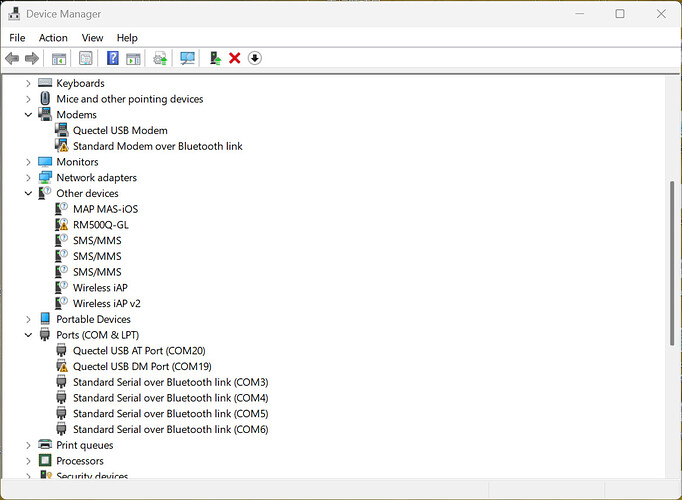

Quectel_Windows_USB_Driver(Q)_NDIS V2.8 (same device manager screen to V2.4.6)
Quectel_Windows_USB_DriverQ_MBIM_V1.3
Quectel_LTE&5G_Windows_USB_Driver_V2.2.4
I also tried QFlash when the driver was Quectel_LTE&5G_Windows_USB_Driver_V2.2.4.

    DM port at 19
    Error in QFlash: DL FAIL, Confirm dynamic com port 19 timeout(N)!

Dear @AChx
AT+QCFG=“usbnet”,3 is RNDIS, please install corresponding driver.
