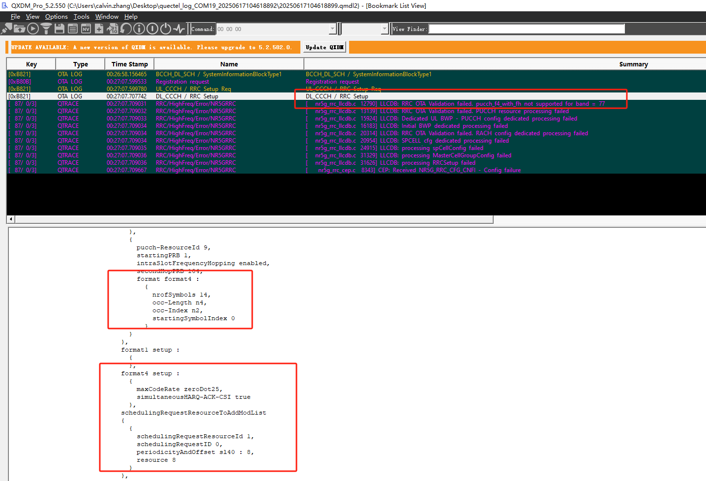

I’m having a problem connecting my Quectel in SA mode. The connection isn’t established, the cell is detected, but the RRC procedure fails after the RRC request.

The UE seems to somehow reject the RRC Setup — at the time of the expected PUSCH there is no power since the EPRE is extremely low (around -114 dBm), which results in no uplink transmission.
Can you please help us understand why the UE does not respond to the RRC Setup and sends no UL signal? Could this be related to firmware, RF calibration, or some internal rejection of SA mode?

You can capture a log which include AT+CFUN=0 and AT+CFUN=1 for analysis.

Attached are the logs captured with AT+CFUN=0 and AT+CFUN=1
quectel_log_COM19_20250617104618892.zip (8.1 MB)
Dear @khadimba
Is it test with instrument? like CMW500 or others?
Is there any other devices work fine in same environment?
Please check the configurations of format4, it reported error.

The test was performed with Amarisoft Callbox Advanced, and I successfully completed the SA test with two phones.
Isn’t it because Quectel doesn’t support format 4?
Best regards.
Dear @silvia ,
I replaced it with format 2 and it attaches in SA now.
