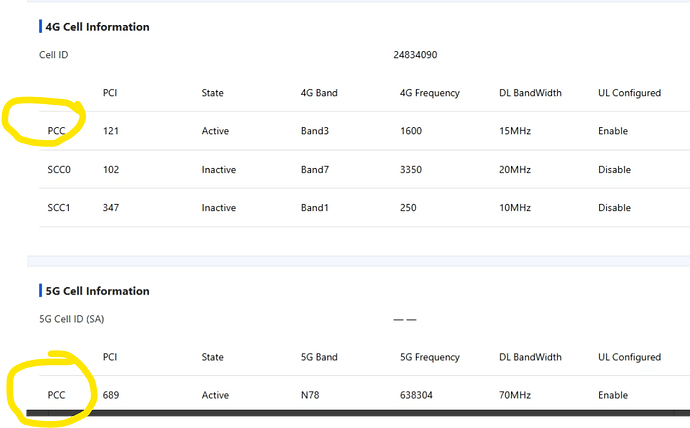

Is the RG650V module capable of dual PCC? I have seen Dual PCC in a ZTE mobile router (where I don´t know the modem module but the chip is X72) and it creates excellent speeds due to ideal CA.
From what I understand it is not normal to have 2 x PCC / Master Nodes. Still I question if it is technically possible with the RG650V module.
I have a mobile router with RG650V with Qualcomm X72 which is not able to do this, therefore the question.

It doesn’t support dual PCC.
The primary cell (PCC, Primary Component Carrier) is the only cell through which the UE (User Equipment) establishes an RRC (Radio Resource Control) connection with the network, and it is primarily responsible for core signaling exchange and critical data transmission.
I am not sure whether dual PCC in a ZTE mobile router is correct, please contact with ZTE.
