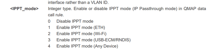

Maybe you can try set the ippt mode to 3.

I think it is better to disable the IPPT.
With disabled IPPT_NAT modem never receives any IP and doesnt work at all
