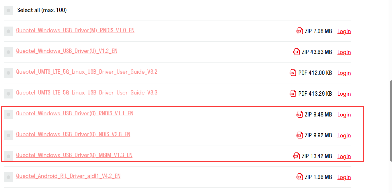

i downloaded quectel_windows_usb_driveru_v1-2_en. QFlash show error: “FAIL, Confirm dynamic com port 9 timeout(N)!” when running
Dear @Nathalya
It seems you had installed wrong driver, please download these drivers and install the corresponding driver depends on usbnet in your device.
