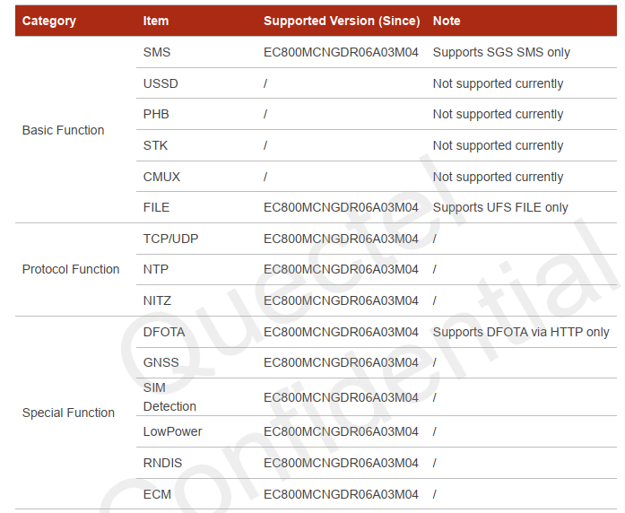

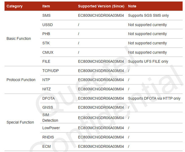

I’m very sorry, the EC800MCNGDR06A07M04 model does not support MQTTs, HTTPs, etc.

I checked many other firmware versions, and they all lacked SSL.
