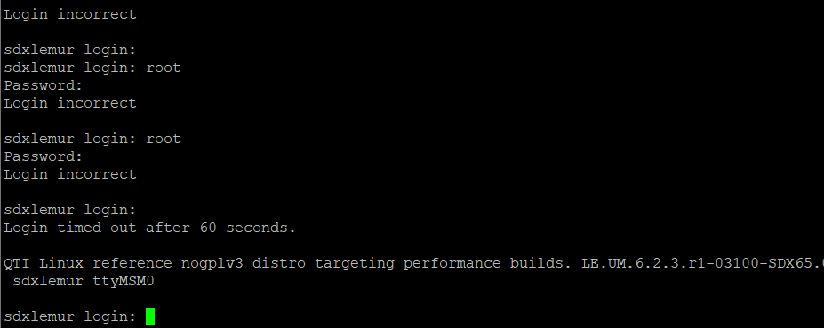

Thank you Niki , but i think you provided adb unlock code, i wanted the root user password for logging in via uart as i am currently cant access the usb. The username is root for uart console, but i don’t know the password for that.
Your help is very appreciated.
ThankYou
Oaky,here is the console passcode, please check, thanks~
Thankyou , i tried that but it didnt work either, LOGIN INCORRECT. I am stuck now. is there any other way to reset the password ?
Thanks
@silvia hi Silvia,could you please help to check this issue?
Dear @BlueNecko
Do you confirm that copy the correct password?
We don’t have way to reset password.
Ughh, I see so we cant do anything with this.
yes i have tried multiple times. Well okay thankyou for your time.

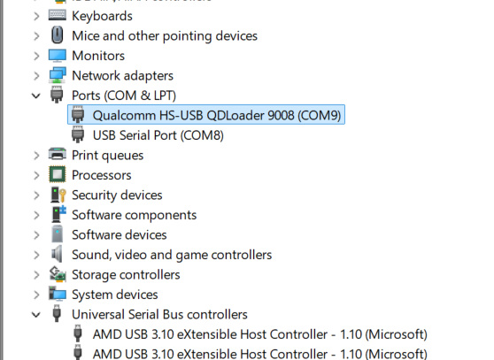

After a lot of struggle i managed to get edl mode working, can you please send me the stock or whatever the latest fw for this module RG520F-JO you have, so that i can restore it to it’s former state.
ThankYou
@silvia can you please send me the full firmware file and method to reflash it for RG520F-JO, since i cant access the module so i cant get the revision no, but i have noted the last revision as |RG520FJOAAR05A01M4G|

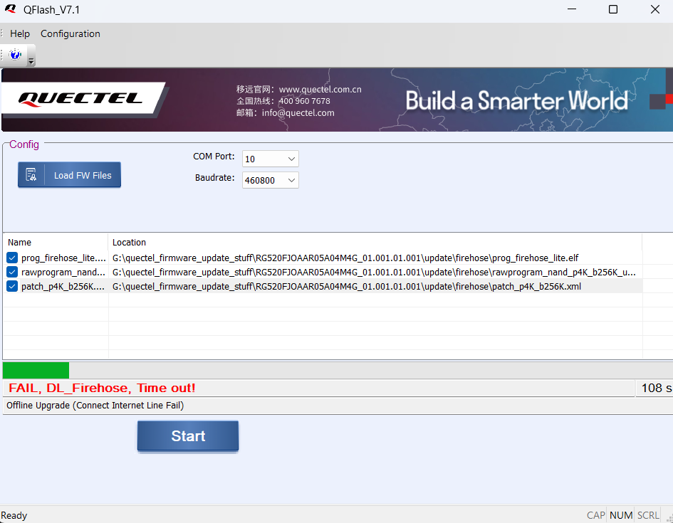

Thank you soo much, but i cannot update it. it fails.
I tried qfill tool to get partition table too but that didnt work either and encountered shara error.

The edl connection cable is stable and powersupply is good too. Can i get the correct firehorse files for this, Is this a common issue or exclusive to mine?
Sorry for the inconvenience,
ThankYou
Dear @BlueNecko
RG520FJOAAR05A04M4G is the latest one.
