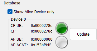

I successfully downloaded and uploaded the file in the app (CATStudio). This is the database status in CATStudio, I wonder if it is correct,
After I set up the configuration of the database, it appears the decoder is not able to properly decode the LTE packets. I mean, the received packets’ descriptions are EARFCN and PCI, and nothing more is showing (I’m currently scanning only LTE data), one sample line is like below:
Device | Index | PC Time Stamp | Comm. Time Stamp | ASN1/ CS1 | Name | Description
0 | 276727 | 26–06-18 11:42:57.601 | 09:04.456.207 | ASN1 | Unkown Message Sent! Type:0, logicChannel 11550185 | EARFCN:100 PCI:383
and the near window, which is used for the decoder to show the ASN. 1 tree for other RATs (e.g., 3G), shows:
’Error decoding ASN1 data from log file:’
The same issue persists for 2G; I can’t parse and decode network packets, however, for this RAT, not the tree window nor the ASN. 1 viewer is empty.
