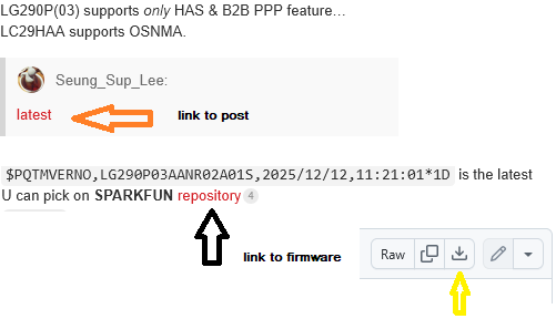

LG290P module support only B2b PPP and E6 HAS
here what U need…

YES Quectel have to provide firmware for LG290P module
-all the LG290P module have the same firmware for the (03) series
-all the branded boards mount a quectel chip and if
immagine
LG290P03AAMD is the chip in question, the latest firmware is this$PQTMVERNO,LG290P03AANR02A01S,2025/12/12,11:21:01*1D
if U have doubt post a $PQTMVERNO*58 output and ask either to https://service.waveshare.com
