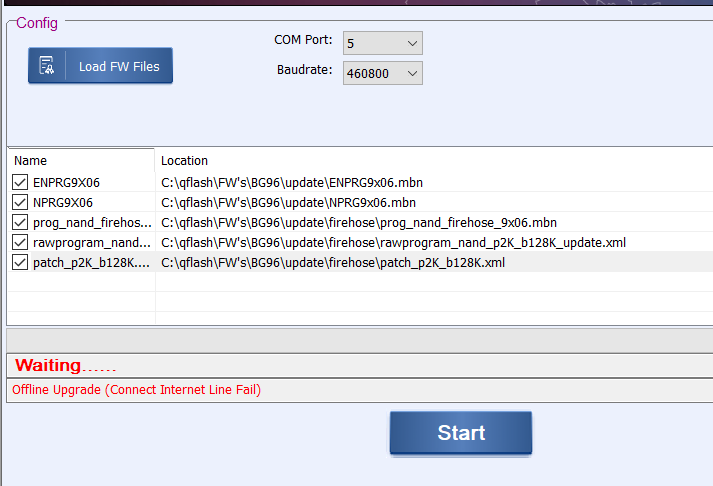

But I have another problem, when I try to update the FW the program gets stuck in ‘waiting…’.
The program is QFlash V7.5 (I also tried with flash 6.8, but I got the same result).
Based in the manual i have to use a baudrate of 460800 and the prog_nand_firehose_9x06.mbn file
Also the BG96 module is located in an EVB Kit base and I am connected to the “main” port (I also tried to connect it to the “debug” port, but I got the same result)
I also updated the NDIS drivers to version 2.8, again, same result.
I would appreciate if you can help me in any step that I am missing to complete the FW update
thank you very much in advance.
[Update]
It turns out that the ports were not recognized by Qflash or QFIL
After further research about the EVB kit, I found out that only the micro USB port of the EVB kit supports FW upload. Once connected, the FW was updated correctly.
