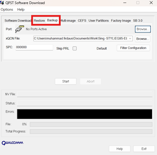

If you have another module with the same FW version, you can back up the CEFS file of the good module and restore the CEFS file to the bad module using QPST tool.
Make sure to flash the original FW to the bad module firstly before restoring the CEFS file.
