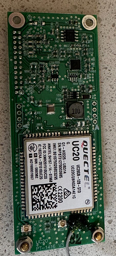

Hi currently I am using device which is 3G to VOIP gateway, but 3g will be switching off soon so I would like to upgrade current device to 4G , I have attached the photo of current module. What will be an alternative of this module for 4G volte capability. Thanks
Hi @Jatin
You can look at models like EC20 or EC25,
