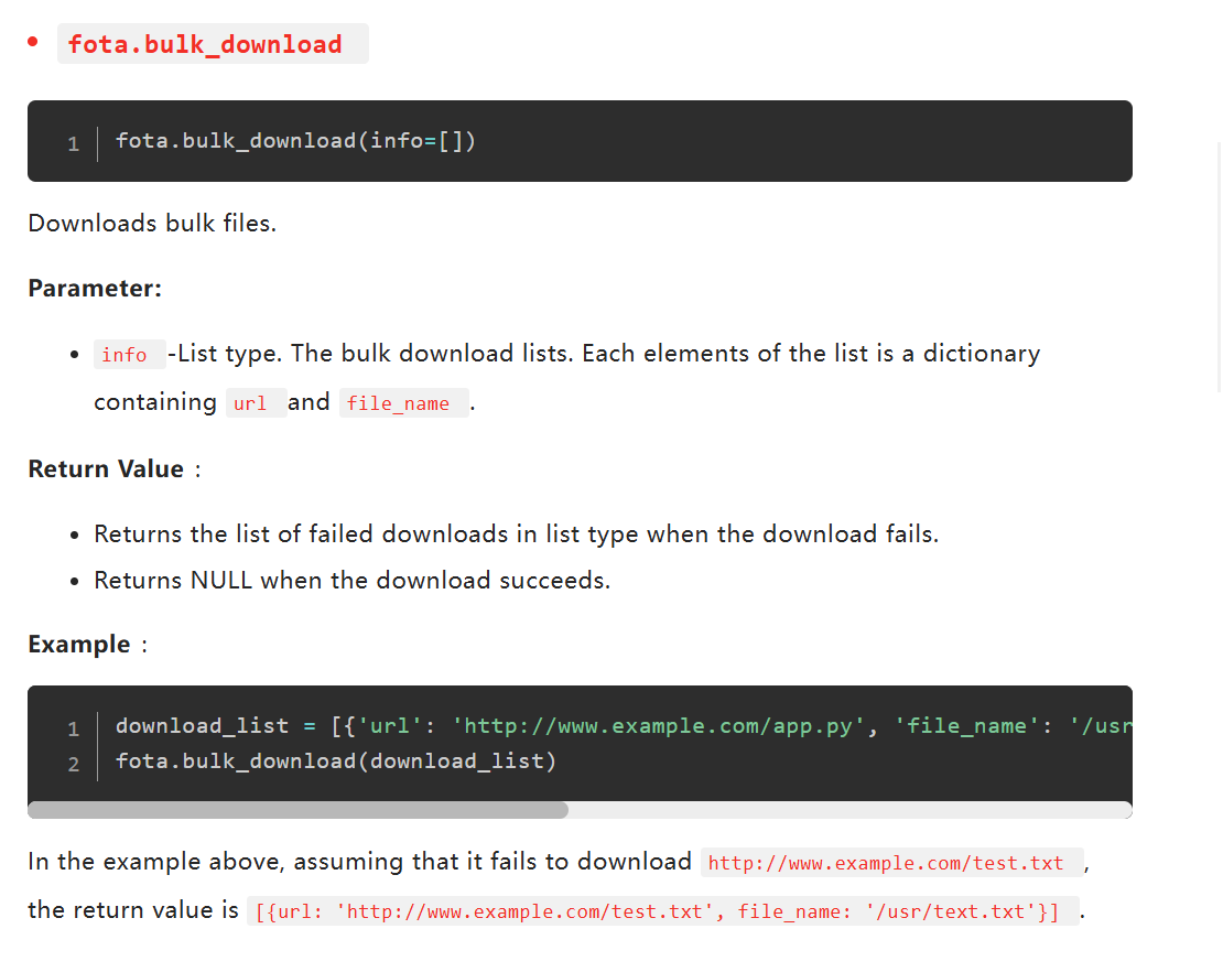

If I switch to App FOTA for updating only the Python files, could you please help me understand:
  • How can I verify that the Python package/script has been downloaded successfully?
  • Is there any mechanism to validate the integrity of the downloaded package before applying the update?
  • Is there a backup or rollback mechanism available to retain the existing Python files in case the App FOTA process fails or the new package is corrupted?
Any guidance or recommended approach for safely updating Python application files would be greatly appreciated.
Also, with the current firmware, we have approximately 380 KB of usr space available. Is there any possibility of increasing the usr partition size or modifying the partition layout to allocate more storage for application files?

About app fota
1,If fota.bulk_download completes successfully, it will return NULL. Please refer to the link below for details.
app_fota - User File Upgrade - QuecPython
2,There is no integrity verification function for App FOTA.
3,The device will roll back to the original version if the upgrade fails.
Partition layout adjustment is supported. please refer to the screenshot below; only the usr and bak partitions are adjustable.
If the space is still insufficient, an external Flash may be required.
