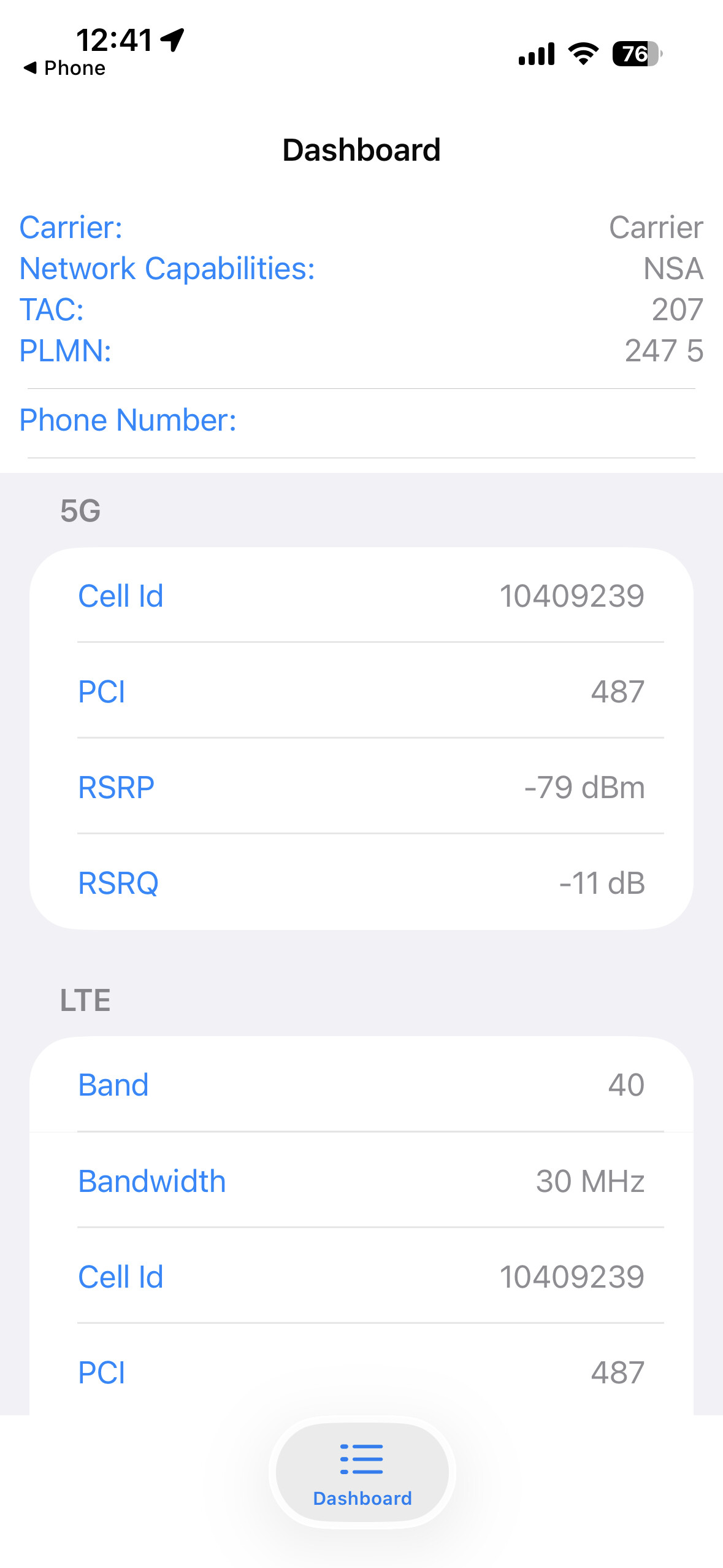

When we insert the same SIM into an iPhone, it connects to 5G NSA on the same operator and same cell immediately with no issues. This
strongly suggests the network is discriminating based on UE capabilities advertised during Attach.

What makes this puzzling: we tested the same SIM in an iPhone at the exact same location, and it connected to 5G NSA on the
** same cell** (PCI 351, Band 28, RSRP −111 dBm — physically identical conditions). The modem received Cause #33 on that same
cell at the same signal level.
This suggests the network is making the LTE Attach decision based on how the device identifies itself, not the SIM
or signal quality.
