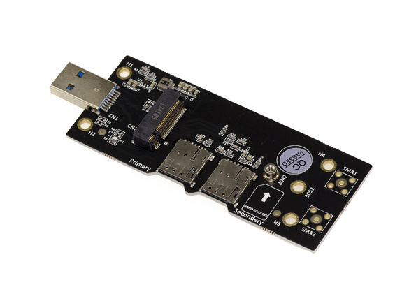

Quectel RM520N-GL USB adapter
Should RM520N work with a “M2 B Key 3042 3052 to USB3 Dual Nano SIM adapter for 3G 4G 5G cards”?
What adapters will work with this modem?
:up_arrow: Paging @Storm-10 or @iamromulan
I bough a waveshare adapter tested with RM520-GL and my machines could not see it.
So I return the modem, I bought it used for a low price.
Did you buy a RM520N-GLAA or RM520N-GLAP?
Cause that limits a lot. The AP version is PCIe endpoint only so those would only work in a laptop with a PCIe m.2 cell modem slot or a desktop PCIe adapter like this one
https://a.aliexpress.com/_mNdN23r
The AA version pretty much works with any adapter you want. The waveshare adapter i’d stay away from unless you are getting the hats for the raspberry pis or whatever. Not very good quality.
What are you trying to do with it?
I bought a GLAP version.
I was trying to use it with with some usb adapter for some computers.
Thus GLAP will work only with PCIe.
