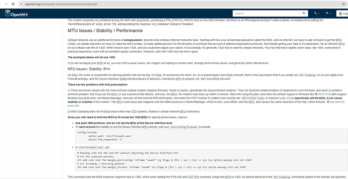

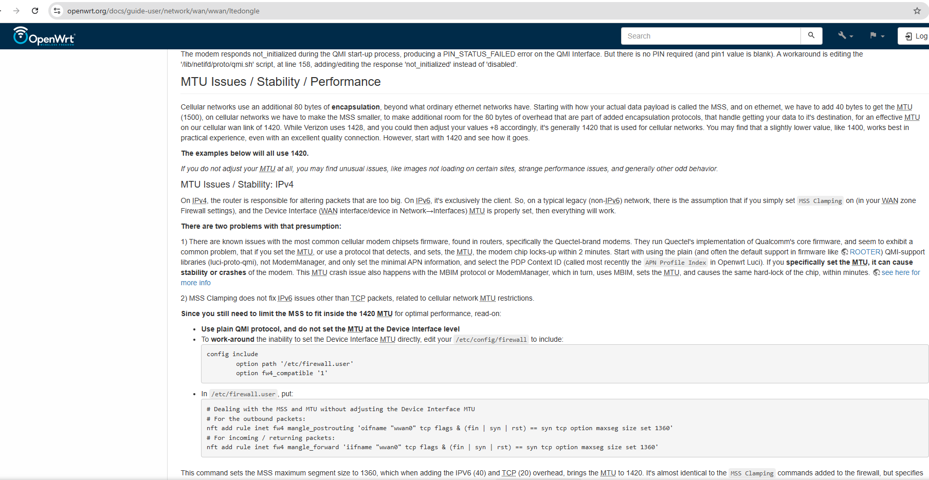

i followed instructions on how to workaround using 1420 as mtu. BTW im only using software offloading as hardware offloading has many issues

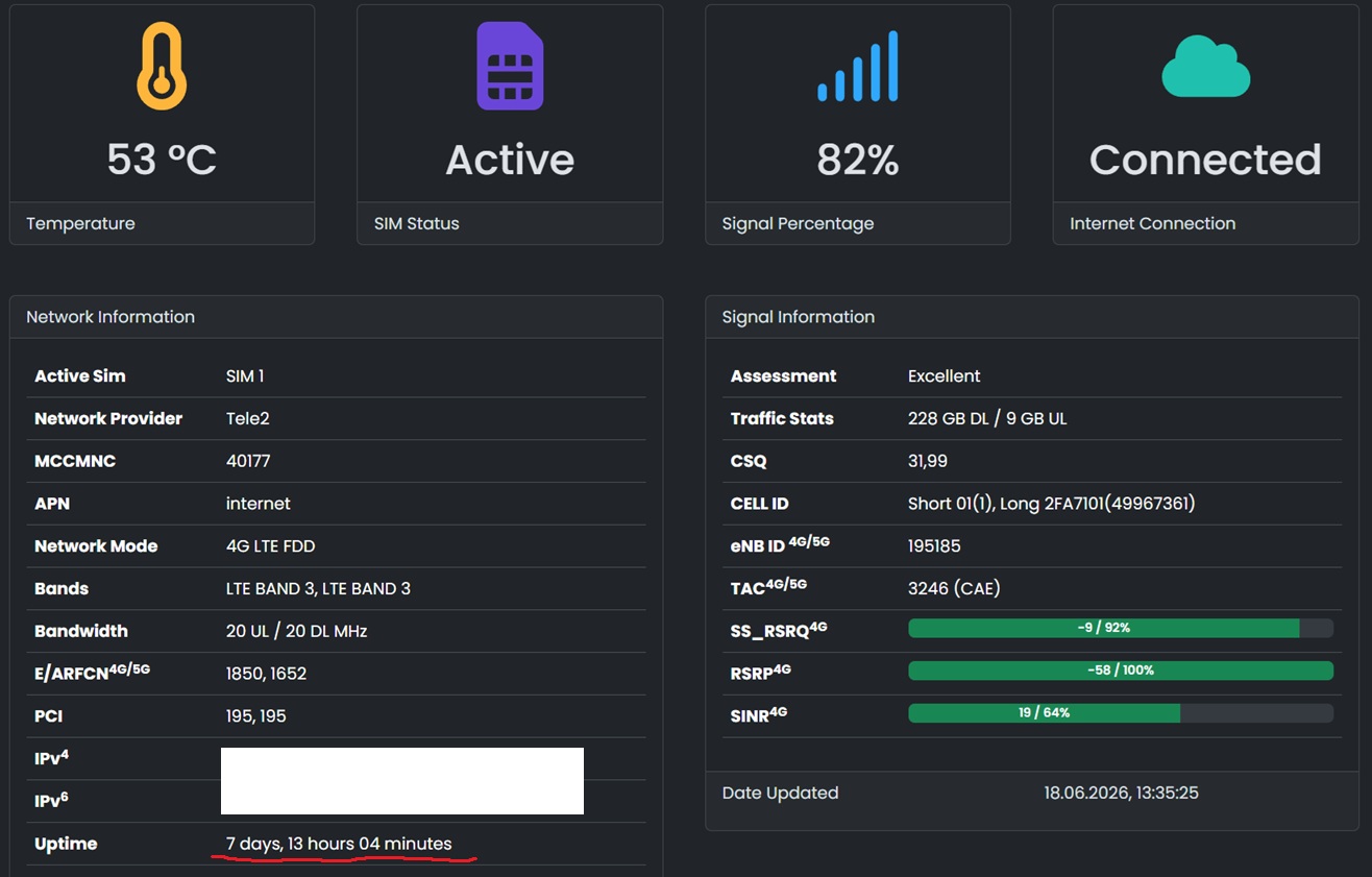

It can run for weeks without any issues, unless the base station experiences any issues or reboots overnight. I’ve noticed that (IMHO), even since using it with a USB adapter on OpenWRT, the modem works reliably in ECM mode and with the 3ginfo-lite package. In our (KZ) area, two bands are mainly common: B1, B3 and N78. I have an MCUzone board with 2.5ETH. Don’t worry about the temperature; it’s 40°C outside, and the modem has been working fine outside for three years.
