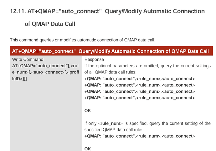

After execute AT+QMAPWAC=1, it need to restart.
You can try at+qmap=“auto_connect”,0,1 .
Dear @silvia
After updating the firmware from RM520NGLAAR03A04M4G A0.301.A0.301 to RM520NGLAAR03A04M4G A0.305.A0.305, automatic network connection works. I haven’t checked the intermediate versions.
