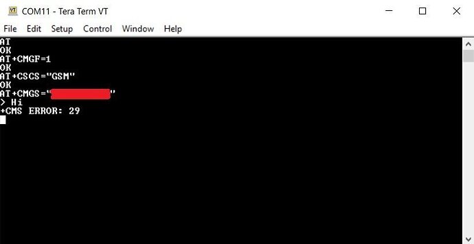

With Quectel MC60 While sending SMS get a response
For Airtel (India)
+CMS ERROR:29
For Vodafone (India)
+CMS ERROR:69
I have completely restored the firmware but still same problem. Call and GNSS working well.
For Airtel (India)
+CMS ERROR:29
+CMS ERROR:69

For CME error 69, resolved this using AT+CGSMS=1.
The software changed this from 1 to 0 and did not change back even after changing the configuration in the UI.
1 = use circuit switching, 0 = use packet domain.
You can check which one is currently active by using AT+CGSMS?
