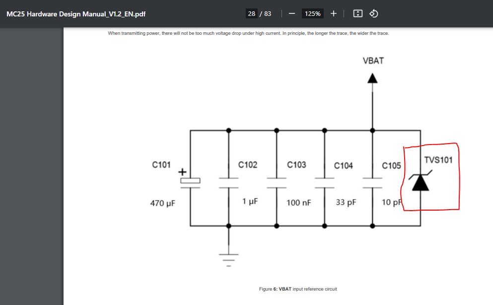

My Module is Quectel MC25, My power supply is 4.2V & 3A, Please suggest me right TVS diode (TVS101) value or part number.
Components with Vrwm greater than 4.2V, not exceeding 5V, and Ipp as large as possible.
please suggest me a part no. thank you
