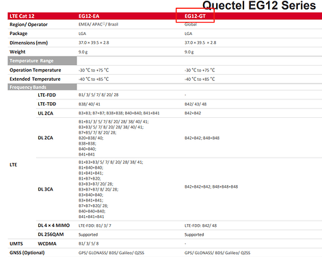

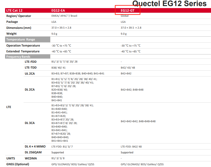

@mikey I was able to flash successfully with EG12GTPAR01A09M4G but I am region locked with this firmware. I’m in the U.S. trying to register on the Verizon network.
AT+QCFG=“band”
+QCFG:“band”,0x0,0x860000000000,0x0
This = band 8, 46, 47 <----- cannot register on U.S Verizon network with these bands.
I need firmware with one of these types :
EG12GNAUAR01A09M4G or
EG12GVERAR01A04M4G or
EG12GGBR03A07M4G
I need the U.S firmware variant that supports Verizon Bands.
The TPAR variant= Telestra/Asia-Pacific
IMEI:869910040047458
@mikey requesting update on my last post sir.
didn’t include these bands you set and you can’t update the firmware which is not EG12GTPA
