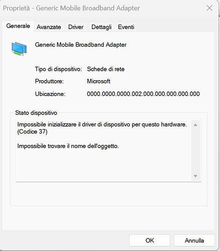

I see the device in device manager with the name “GENERIC BROADBAND” DEVICE
Here is the link at the image screenshot!!!
As you can see near “UBICAZIONE” (POSITION) a bounch of zeroes…that s because i think the firmware is corrupted!

See image: still yellow warning triangle in device manager: QUECTEL WWAN recognized as GENERIC BROADBAND DEVICE with standard Microsoft Drivers installed
