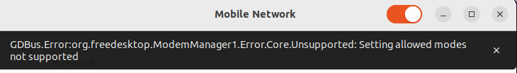

The modem is failing to connect because its trying to find the ppp_generic device. I would like to use the 4G only mode that does not require this device. The problem is that when I switch to 4G only, I get an unsupported error:
I have tried to use the picocom AT terminal to force the $G only mode but that didn’t work.
Any ideas?

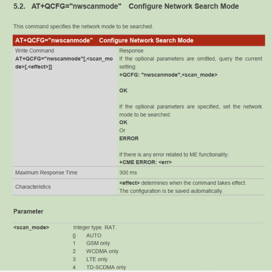

Hi @Gali
You can access the USBAT port and then use the following instructions to set the network mode.
