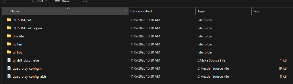

Later, I tried to port the same firmware to the EC200U-EU module. I rebuilt the project using the following command:
sudo bash ./build_all.sh new EC200UEU_AA appimage
Then I flashed the generated .pac file onto the EC200U-EU module.
