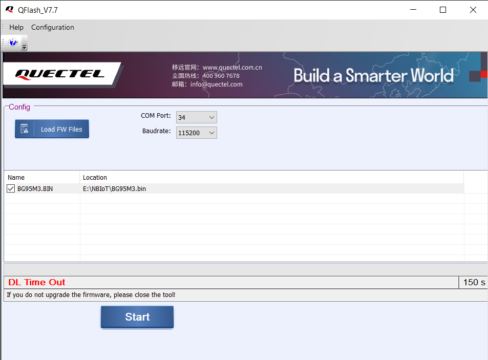

Now, no USB ports are listed in device manager.
When put the device in boot mode using BOOT BTN, Quectel USB QDLoader was listed in COM Ports.
But unable to flash firmware using QFlash saying unable to read com port. Also tried with QPYcom to download the firmware but no ports detected error message is returned.

hi
  1. The BG95 module has no AT port; firmware downloading is performed via the DM port.
  2. Device restart can be implemented via our interface: Power.powerRestart().
  3. Could you share the specific firmware version you downloaded and the exact model of the module? I need to verify if the firmware is compatible with the module model.
