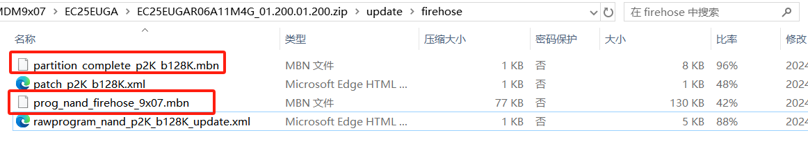

You need to extract the firmware package and import the correct file
Really strange, for my FW package update, using the .zip file was working fine with no error.
So, I have:
  • BG96MAR02A07M1G_01.202.01.202
  • BG95M3LAR02A03_A0.206.A0.206 3.zip
  • EC25EUGAR06A11M4G_01.200.01.200.zip
WHen extracting those archives, could you tell me which file is the “correct file”?
You need to unzip these files
And when unziped, what file should be selected?
Could you please give the name of the correct file. I cannot guest it.
I tried with the prog_nand_firehose_9x06.mbn file for my BG96. The device seems now to be bricked. It only provide a “Quectel QDLoader 9008) interface”. What should I do to unbrick it and restore the other interface.
The BG95 archive got a .elf bin that allow to update. BG96 and EC25 do not have .elf. So, what is the “correct file” for those two devices? Should I select MBN autoset?
When unziped, one of these two files can be used to update

The device FW version is BG96MAR02A07M1G_01.200.01.200, trying to update to BG96MAR02A07M1G_01.202.01.202 2.zip (and I would suggest you to remove the " 2" from the name as QFlash do not accepts space)
Hi
You can remove the “2” and the process to update a BG96 is the same as EC25 actually.
