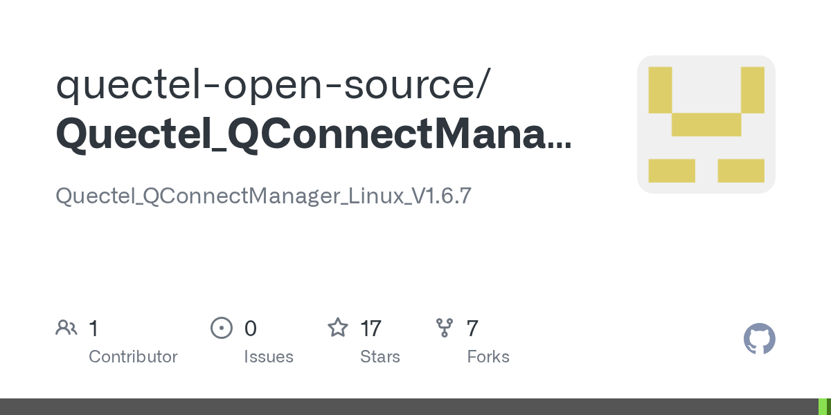

I found a Git repo that has version 1.6.7—Is this repository official?
Previously, with version 1.6.5, I connected using quectel-CM as a QMI device and it worked,
but it doesn’t work on 1.6.7.
Could you help with this?
Please try the 1.6.8.
q_drivers/Quectel_QConnectManager_Linux_V1.6.8 at master · QuectelWB/q_drivers
