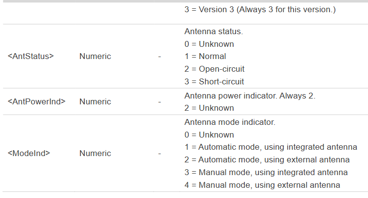

[2025-07-18 12:14:21.262] NMEA[PAIR080 Drone mode]: $PQTMANTENNASTATUS,3,1,2,1
52

Hi Ludovice_Lervolino,
$PQTMANTENNASTATUS,3,1,2,1*52 this message shows the module worked with passive antenna(patch antenna).
Did you test indoors? From $xxGSV message, it showed that module had completely no satellites in view. Please move to an open sky area for GNSS performance evaluation.
For a quick GNSS test, you can do it by the window. But usually the signal level will also be bad.
Best regards.
