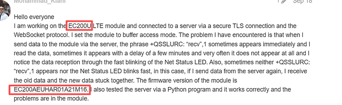

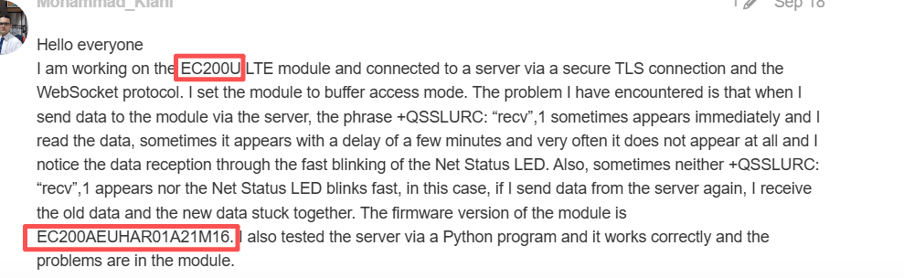

Hello everyone
I am working on the EC200U LTE module and connected to a server via a secure TLS connection and the WebSocket protocol. I set the module to buffer access mode. The problem I have encountered is that when I send data to the module via the server, the phrase +QSSLURC: “recv”,1 sometimes appears immediately and I read the data, sometimes it appears with a delay of a few minutes and very often it does not appear at all and I notice the data reception through the fast blinking of the Net Status LED. Also, sometimes neither +QSSLURC: “recv”,1 appears nor the Net Status LED blinks fast, in this case, if I send data from the server again, I receive the old data and the new data stuck together. The firmware version of the module is EC200AEUHAR01A21M16. I also tested the server via a Python program and it works correctly and the problems are in the module.
