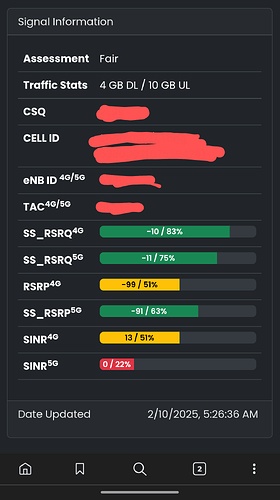

I am currently using the V2 of that board with good results (between 200 and 400mb/s down and around 50mb/s up) under mediocre signal. Similar results through USB and Ethernet.

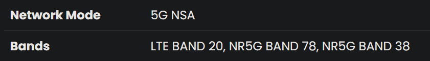

It seems that it is in 5G NSA but not SA.
That’s correct, there is no support for SA in my area quite yet.
The performance is as expected. WIth SA network it could be much better.
The signal strength seems not quite good.
