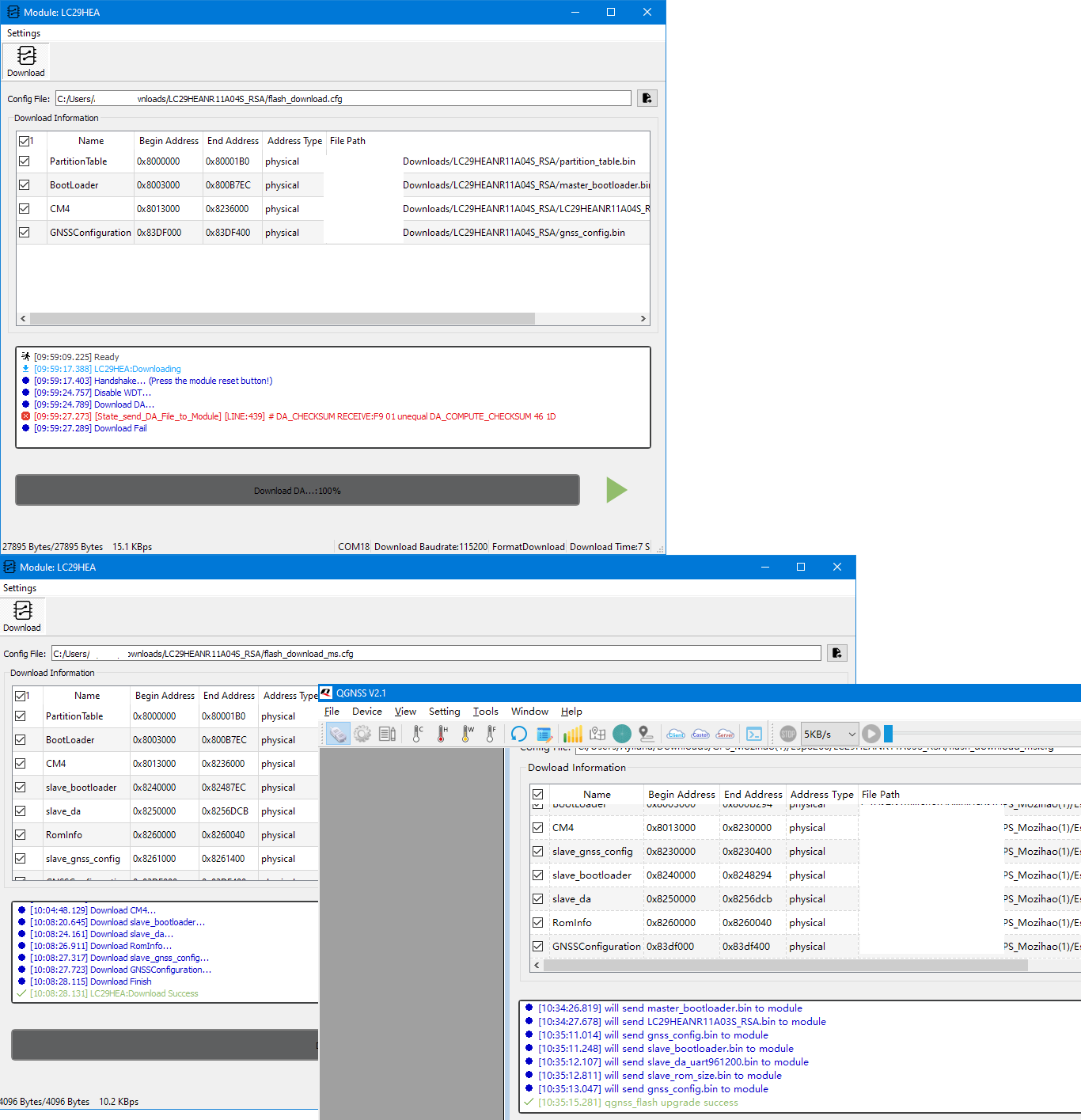

  `$PQTMVERNO,LC29HEANR11A04S_RSA,2025/04/02,15:51:16*2D
but be aware choose flash_download.cfg for working module…
after many attempt flashed the full flash_download_ms.cfg , but module spits raw tx only.
Only after I succed to flash with correct one succesfully.
