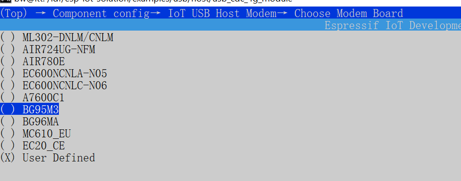

I think you misunderstand. I don’t want to do ota for BG95M3. The OTA is for esp32 but by using cellular data through BG95M3. ESP32 is not capable to have cellular data. That is why i’m thinking to make bg95m3 as a ppp device or maybe some other method to enable esp32 to do ota through cellular data (GSM/NBIOT).
ESP32S3
GitHub - espressif/esp-iot-solution: Espressif IoT Library. IoT Device Drivers, Documentations and Solutions.
examples/usb/host/usb_cdc_4g_module
I am not sure it is what you want.
