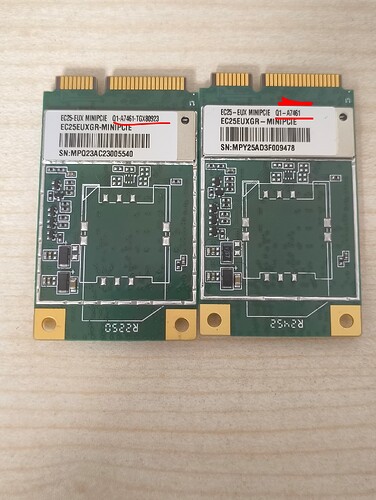

I have two EC25 modules. One of them works perfectly and connects to the network without any problem.
The other one doesn’t register to the network at all.

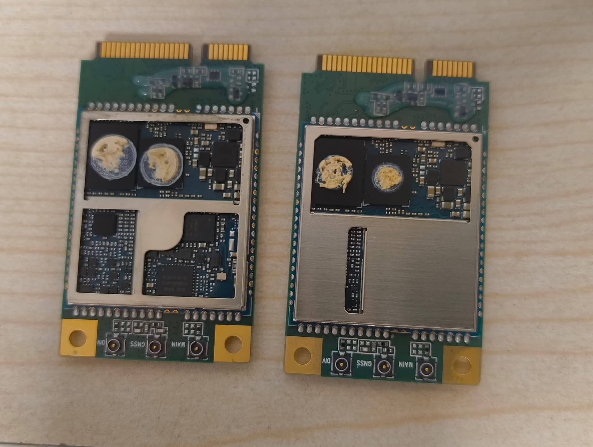

The label on the back of the module is incomplete, and I opened the shield — the internal PCB layout under the shield looks different from the working one.
Could this module be a fake or a clone?
What can I check to confirm whether it’s genuine or not?
Which AT commands or information should I provide here to help identify the issue?
Thanks in advance!

Dear @madelat ,
Thank you for the detailed information and photos.
Based on the AT log you shared, this is not a firmware-version issue. The non-working module is not registering because it is not detecting any usable RF signal. Specifically, AT+CSQ returns 99,99 and the registration status remains +CREG: 0,0. When the module cannot measure signal (CSQ 99,99), it will not be able to camp on a cell or proceed with network registration.
Also, a different PCB layout under the shield does not by itself indicate a fake module. Hardware layout and shielding can vary between genuine production batches and revisions. The definitive way to confirm authenticity is through traceability identifiers (IMEI/SN/PN) and verification via the official sales channel.
