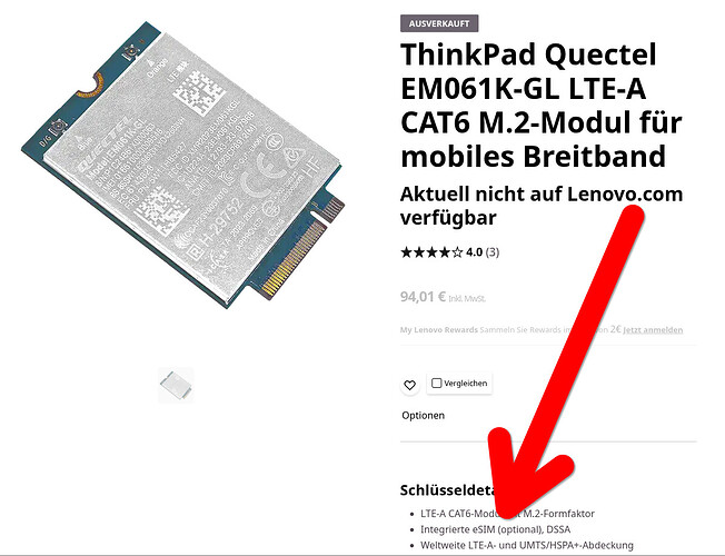

I also have a picture of the device itself. So you can be sure it is a EM061K-GL.
OK.
Please try
sudo modprobe option
echo  2C7C 6008 FF | sudo tee /sys/bus/usb-serial/drivers/option1/new_id
And then you might see the /dev/ttyUSB0.
Please check whether you can send the AT command via that port.
The version you tried might not support USB AT command.

Also (sry for double post I cant edit)
everywhere I look itsays “eSIM Optional” does that mean that not all of this model have esim, or that it depends on something else
