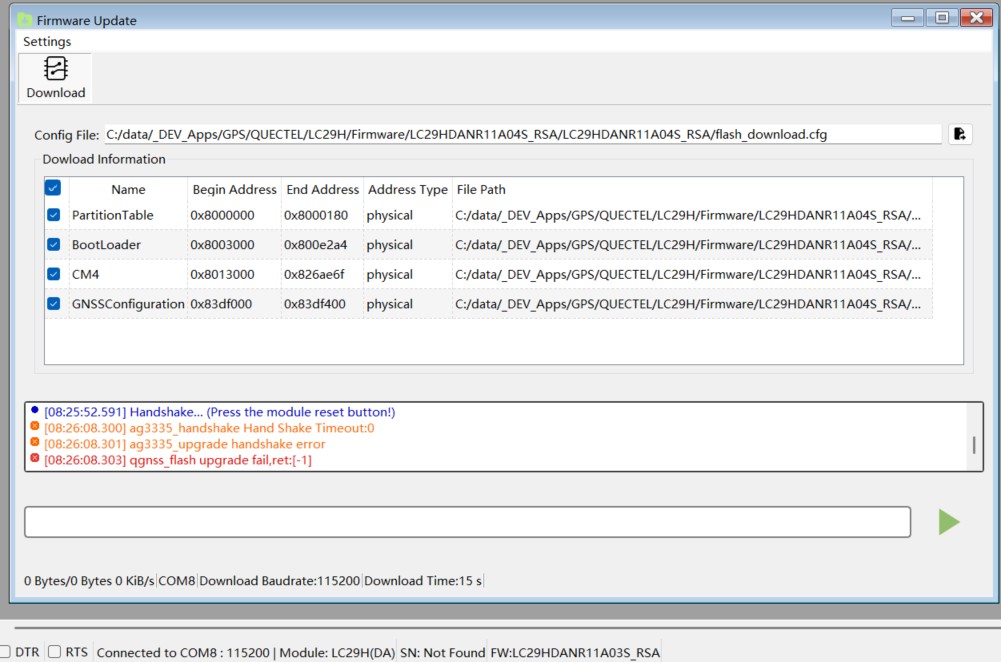

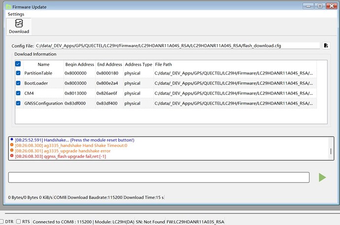

I am trying to upgrade it through QGNSS v2.2 but it is not working.
I keep pressing the board “Reset Button” but nothing happens, I get the attached message.
Please let me know how to proceed. Thank you again.
PS: My board is manufactured by “Waveshare” and it is a HAT for a Raspberry Pi Zero 2WH.
I have tried with the board connected to the Raspberry Pi, and also with the board only connected to the PC via USB, both fail.
@Profile - YongHuang - Quectel Forums
This is the error that I get.

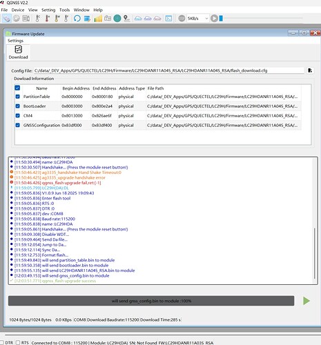

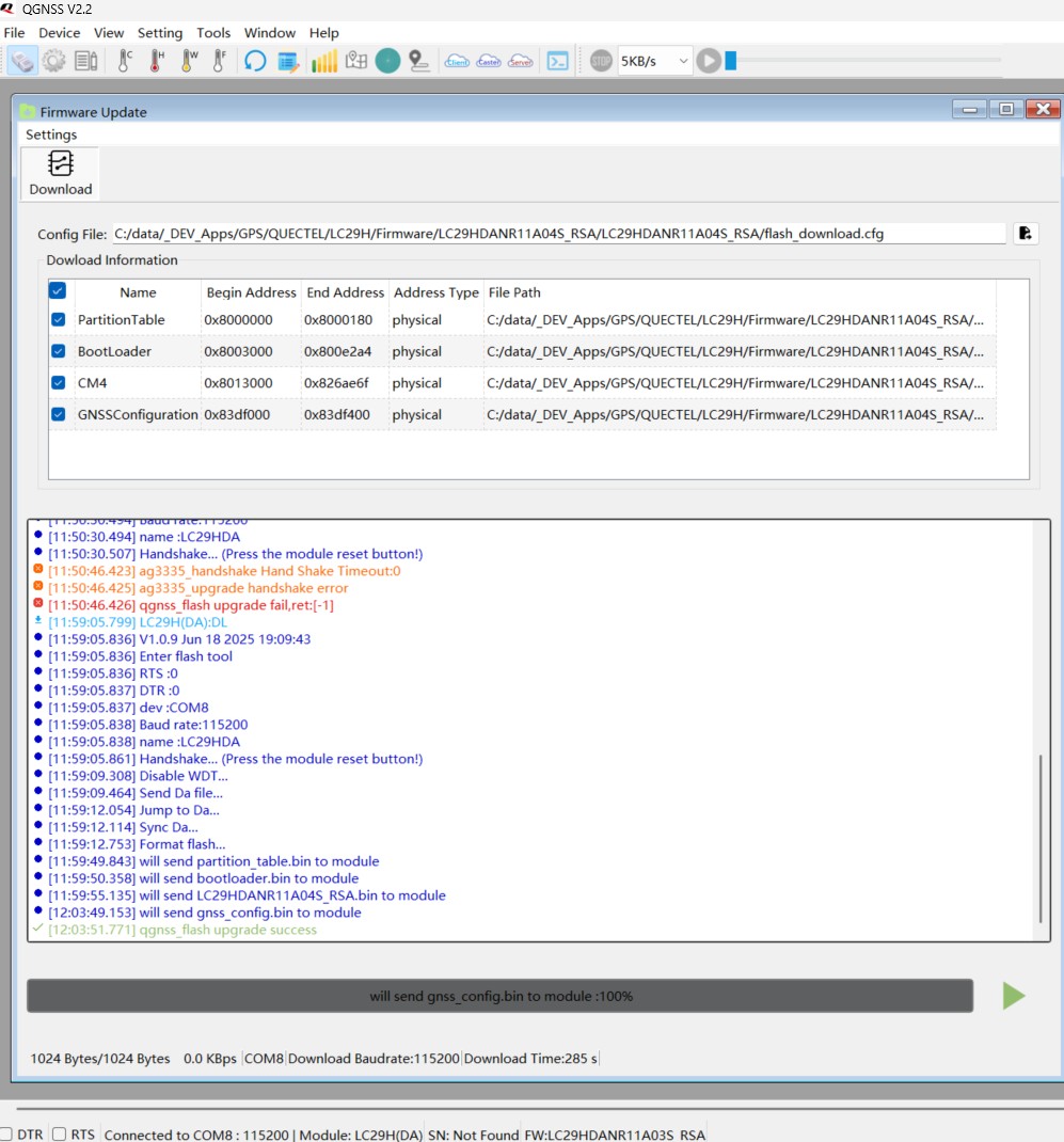

Hi @Profile - YongHuang - Quectel Forums
I just solved the issue.
Once the GNSS board is connected and the serial port opened in the (QGNSS v2.2) software, you must press the “RESET” button BEFORE pressing the “PLAY” button for Firmware Upgrade.
See attached screenshot.
Now the board has been upgraded to v4 firmware and it gives the GST message.
Fantastic product, thank you!
