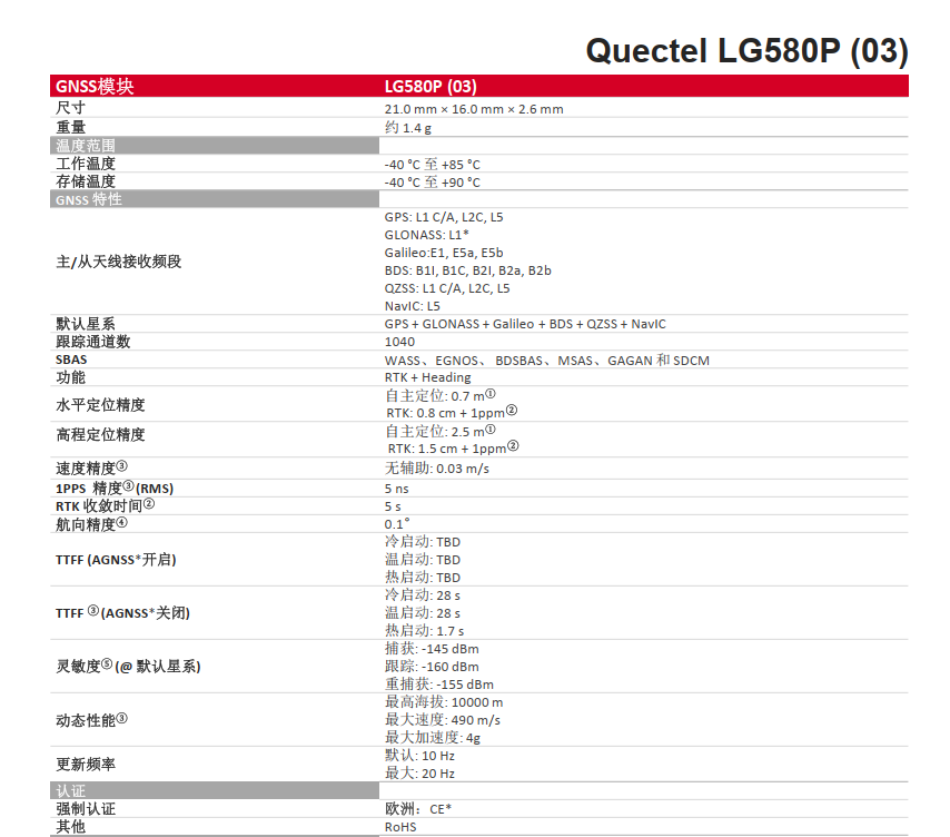

Hi Luke
I’m just reading today…
It seems they have given up on the E6 but above all
to the evolution of the Beidou-3;also the B3I signal has disappeared in the B3 Band…
Module spec
Ti saluto
It is the same chip with the same number of channels as the LG290P, but for this module they’re doing two antenna direction so they need to use a bunch of those channels for the second antenna’s location algorithm. I’m not surprised that they removed support for some of the more esoteric signal types to make it work.
See the “U” (not “u”) vendor’s UM98X models for an example of this. The 980 can track some signals that the 982 cannot.
After all I think it’s a firmware matter (on 290P).
