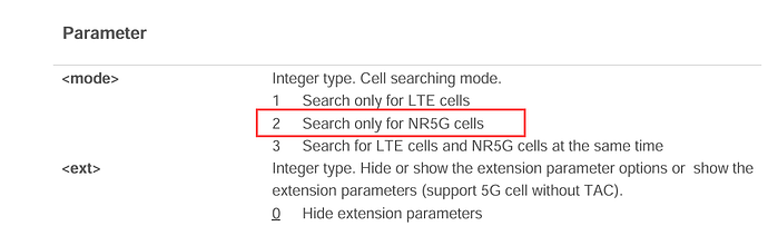

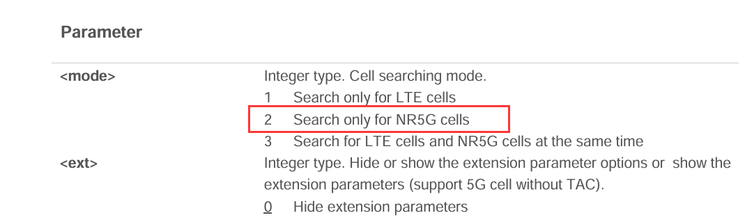

For LTE AT + QSCAN = 1,1 is working every time.
for LTE AT + QSCAN = 2,1 in not working have any suggestion why it happened.
If I do not execute frequently try after wait of 1 hour result is same.
please look out the problem.
Dear @Vinod_Malik
For 2, it is Search only for NR5G cells.
I know sir I want to say that only 5G network scan is creating issue LTE 4G working every time good. Need to solution for NR5G Scan.
