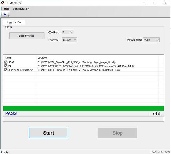

I’m using sdk 1.7. Flashing go well, but after reboot it spams Boot failed, reset… or keeps silent.
When i flashed custom example in first time, it was well, but when i reflashed it with another, it had no affect (printf in uart was the same). Does QFlash not removing current fw? What am i doing wrong?
I’m using QFlash 4.19 and every time process completes correctly.

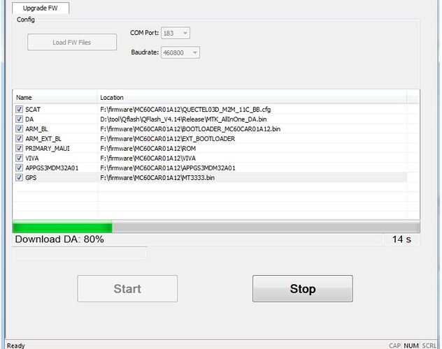

Also I have questions what firmware is placed in \QFlash_V4.19_EN\QFlash_V4.19\Release\dl_src\MC60?
Why it has different cfg file from generated from sdk? What is ROM, VIVA, EXT_BOOTLOADER and so on?

Thanks for your reply.
I used sdk in command line and in eclipse, same result. Compilation and flashing goes well, but device does not response to AT commands.
I used qflash 4.19.
Maybe I erased some important sectors when tried to flash this (\QFlash_V4.19\Release\dl_src\MC60\1)?
Can you please send me base firmware wich is 100% working? That is shown in qflash user guide pdf
