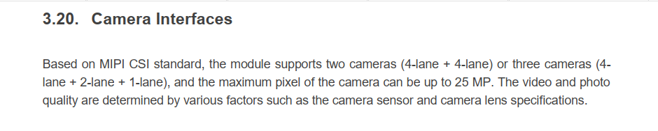

I see in the documentation for the SC20 series smart modules the possible combination of MIPI CSI-2 cameras that can be connected, is it possible to connect a 48MP single camera to the SC206E module or is it a hard 25MP maximum limit? Is the limit in the ISP of the smart module 25MP?
Please check the SC206E cannot support the 48MP single camera.
I already checked, the question was, is this a limitation of the hardware ISP or the gstreamer platform source pad? Especially for raw image frame and not video streaming.
It should be both Hhardware and software linitation.
